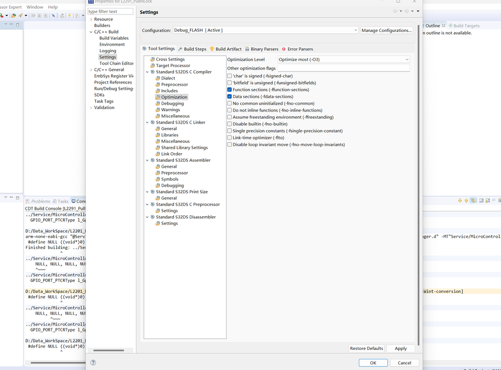

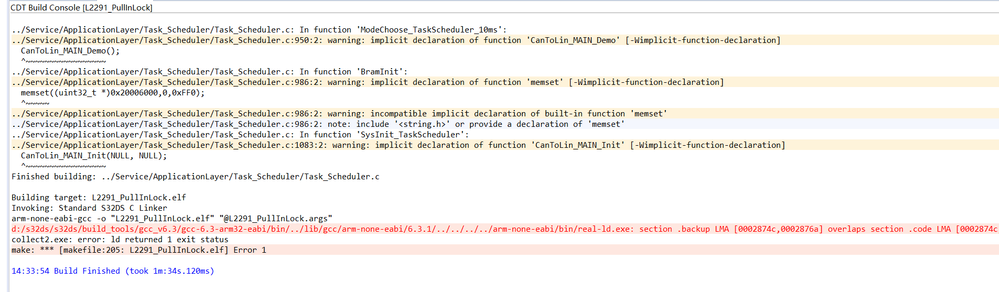

I encountered the following issues during the development of the S32K144
Listen to the suggestions of colleagues to open the optimization level, but still compile Failed

According to you screenshot the linker detects overlap between .backup and .code sections.
I'd recommend you to check generated .map file to confirm the overlap and adjust linker command file (.ld) section .backup or .code to avoid overlap between these two.
Hope it helps
