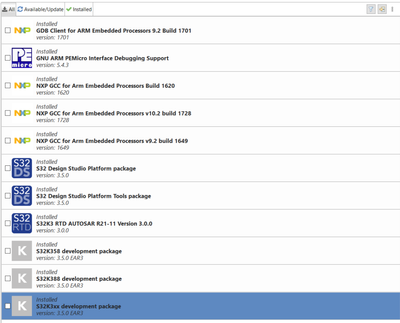

I recently installed S32DS3.5 and the attached image contains the  all the packages I installed along with S32DS. When I try to create an application project, I cannot see any SDK in it. Also, when I try to create a new project from example, I cannot see any examples. How do I get the SDK? should I install anything else?

VaneB
Hi @ukn
I ask you to please provide an image of the information provided in the installation details. This situation usually happens when it is not installed all the necessary packages or if you do not have the right version of these.

ukn
Hi @VaneB ,
I reinstalled the S32DS3.5 and the related packages and it fixed the issue.
