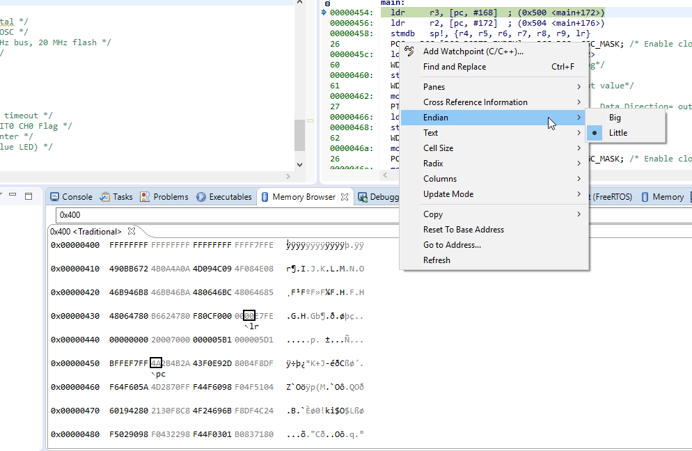

Is it possible to display memory in big-endian? I know this option (switch between endian format) is availble on S32DS-PPC.

Hi David,
you can choose endian in Memory Browser view. On main menu bar go to Window->Show View->Memory browser:
Jiri

MPC8313ERDB_h
Thank you Jiri.
I was confused by Memory (Rendering Section) Property where it says that the  "Data Endian" is little endian (but actually the display is big endian).

jiri_kral
Hi David,
in memory view is the endianness showed correctly:
But in Memory Browser view is output swapped out. I never notice it - thanks for report. I'll create bug ticket.
