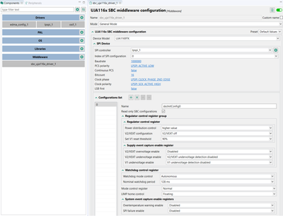

I am using S32DS 3.4 Platform for a project.
I can find the sbc_uja116x_driver in the Components window (Middleware), but the sbc_uja113 is missing.
I have found the sbc_uja113 driver in the Components window of the S32DS 2.2 ARM version, but I must use 3.4 Platform version.
Can I manually add the sbc_uja113 driver in the Components library of S32DS 3.4 Platform IDE?
I need to use the Middleware configuration window to configure and generate code for UJA113x SBC driver as in the picture below:
Thank you in advance!

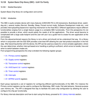

Hi Andrei,
the files are present in the SDK:
However, if you take a look at the user manual (for example c:\NXP\S32DS.3.4\S32DS\software\S32SDK_S32K1XX_RTM_4.0.1\doc\S32SDK_S32K144_UserManual.pdf), you will find this explanation why there's only low level API and why there's no standard driver with GUI initialization:
