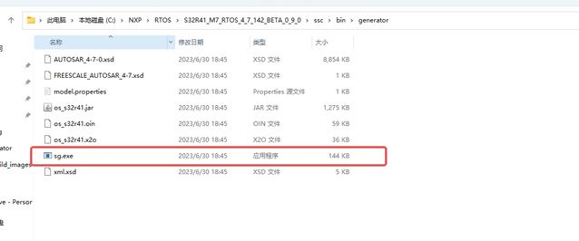

No file is generated when this key is pressed
The os configuration file for this project is not generated

The problem has been solved.This is a problem with the executable files in the version.I just replaced the 0.8 version with the 0.9 version.And I dont know why the sg.exe with 0.8 version execution error.Prompt information in the fourth picture.
Thanks for your reply.
