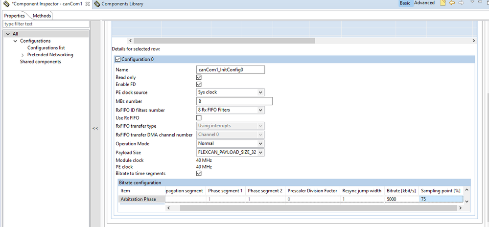

sreevishakhkp
Hi Jorge,
Thanks for your replay.
From flexCan component clock configuration its showing at 40MHz external clock only it will configure bit rate to 5000Kbps.Is it possible to use internal clock sources.FlexCAN.png

jorge_a_vazquez
Hi Sreevishakh kp
The oscillator clock should be selected whenever a tight tolerance (up to 0.1%) is required in the CAN bus timing. The crystal oscillator clock has better jitter performance than the peripheral clock.

sreevishakhkp
Hi Jorge,
The CAN configuration shows only one Bit rate setting .As CAN FD supports different bit rates for data and Arbitration field,where I can set different bit rates?

jorge_a_vazquez
Hi Sreevishakh kp
If you scroll down in that field, you can see the data phase too:
Jorge Alcala
6,001 Views
sreevishakhkp
Thanks a lot Jorge
