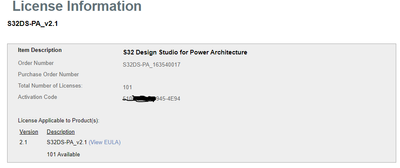

I have a issue with installing S32V2.1 on my Windows computer.
I use my office PC and have got the right permissions to install softwares. Whilst installing it asks for the license information and when I copy and paste it in the box the installation is rolled backwards for some reason. Could you please help me with this? What could be the issue?
I have attached the logs and screenshots of the installation for the reference.
Thanks in advance.

S32V is an ARM-based processor. Based on your logs, you attempted to
install S32DS for Power Architecture. If your license is for S32V, it is
not valid for S32DS for Power Architecture.

Hi Platon,
Thank you so much for your reply.
But I think I have the right license key from NXP which I am using to install. I might have created the issue in the wrong forum but I am attempting to install S32DS and using the license key for S32DS. (See attachment) .
Seems an administrator issue, my company provides admin elevation for 5 min in my computer. I am not sure why when it starts taking the license, Java script starts and the installation rolls back. If you have come across similar kinds of situations or issues before?

Hi Matheen,
it looks that that in time of installation installer can't write some data into temp folder. Can you please share additional .log file - from last installation attempt it is this file:
C:\Users\matheen.mohammed\AppData\Local\Temp\I1603878892\Windows\hs_err_pid23704.log
For other install session the PID number will be different. Thanks.
