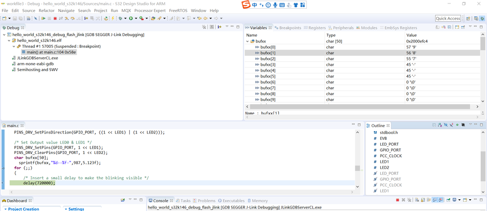

hello,
Use S32DS own “ hello world ”example, add “sprintf (bufxx,%d--%f,987,3.14f)” ,but bufxx Only int data, no float data。

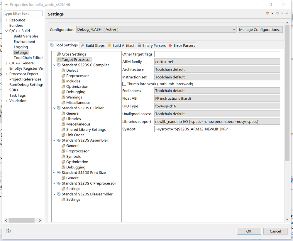

jiri_kral
what is your STD C library?

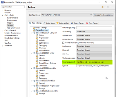

gravity_one
hello,jiri
It is right to compile according to the selection on your picture!
Can you explain why?

jiri_kral
NewLib nano is more compact and there are missing some features - like float point printing. You can find more details for example here: https://imagecraft.com/blog/2019/04/embedded-gcc-libraries-newlib-vs-nanolib/ .
