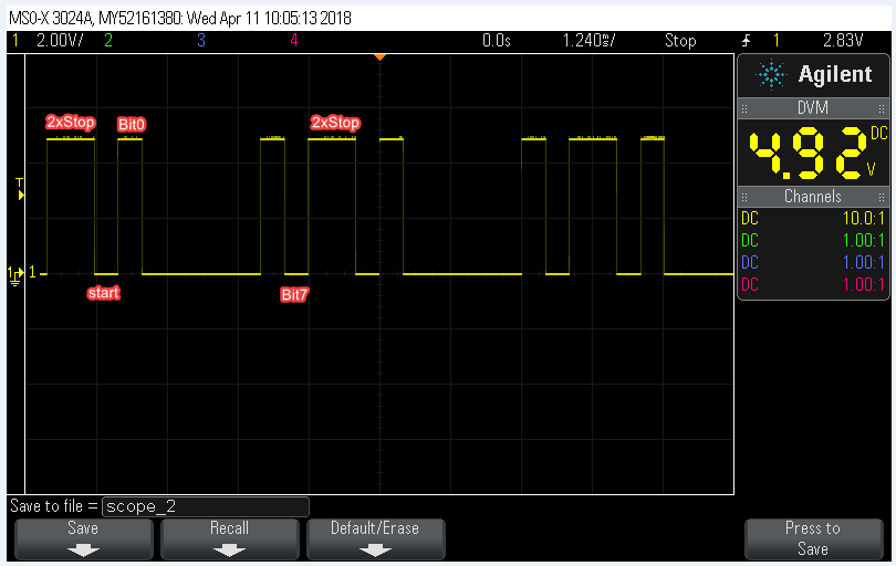

I'm using a development board S32K146 and working with the LPUART, i did the configuration using the SDK 8.5.
The configuration is:
Baud rate: 2400
Parity: even
Stop bits: 2
Data: 8 bits
8 bit data + 2 stop bits + 1 parity bit + 1 start bit
The communication is working using a terminal and a TTL cable. I watch the trace using an oscilloscope and a saw that there is something incorrect in the frame.
As message I've sent two 'A'->"01000001" this will throw a 0 as even parity bit.UART trace.JPG
As we can see in the image, I'm missing a bit in the trace and I think this will be the start bit
Using the reference manual I don't see any register where I can enable the start bit, neither in the SDK window on the S32DS.
Someone knows how to enable the start bit in the trace?
Thanks in advance

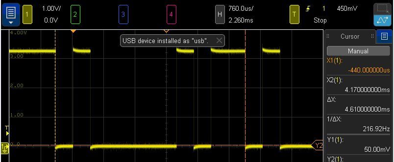

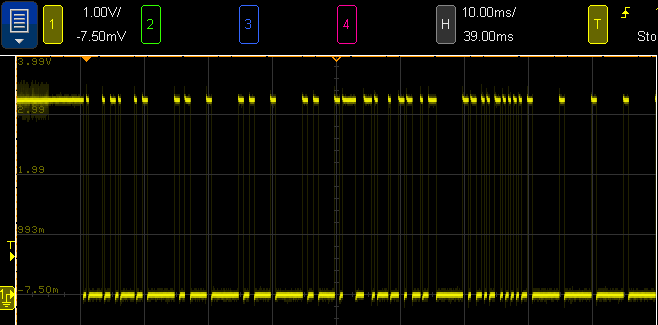

I got another one,
After we change the configuration from 8 to 9 data bits, the first data byte is correct as you verify with the scope, but the SW got stuck in this function:
while(LPUART_DRV_GetTransmitStatus(INST_LPUART1, &bytesRemaining) != STATUS_SUCCESS)
Sending bytes in the bus.
welcomeMsg is only "AA"
What could be wrong? did I miss something?
The only change made was using the SDK changing data bits from 8 to 9.
Thanks in advance
4,492件の閲覧回数
jiri_kral
Sorry - I forgot add non SDK fix -
just put
LPUART1->CTRL |= 0x10;
after
LPUART_DRV_Init();
This set CTRL.M bit to 1 - 9 bit character length. Also don't forget set character length to 8 bits in Processor Expert and generate PE code.

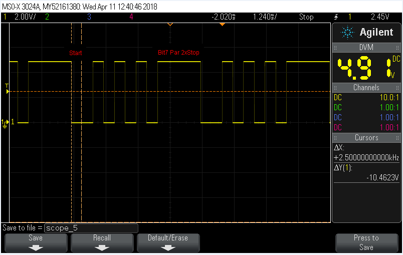

jiri_kral
Hi Raul,
I forwarded this thread to SDK team. Basically - with Parity enabled you need 9 bit data length where you don't care about 9th bit, but it can be done only with two bytes per character. Technically - it is nonsense, because you just need to use parity - nothing else.
With current SDK I'm using as workaround this:
uint8_t datai[256];
for (int i=0;i<256;i++)
   if ((i%2)==0)
      datai[i]=0xAA;
else
      datai[i]=0x00;
LPUART_DRV_SendData(INST_LPUART1, datai, 256);
this allows me to send 128 bytes of data with parity...
Hope the SDK team will have better solution - may be I overlooked something.
Jiri

jiri_kral
Hi Raul,
First of all - thank you for report. The Parity bit is affecting last data bit on hardware layer. As workaround you can use data size 9 bits. In this case is parity working okay and terminal is happy. With 8 bit data size is lost MSb. I also checked EmbSys registers - and CTRL is set correctly.
For testing I used 0xAA data and Odd parity - terminal received 0x2A - here is frame( Bit7 is overwritten by Parity)
Scenario with 0xAA and 9 bit data:
Jiri

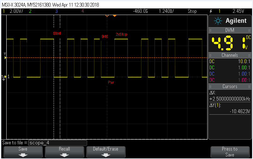

jiri_kral
the start bit is not configurable - it must be always present. I tried your scenario - and it looks like that there is no Parity bit - even if it is enabled. I'll try to figure out what's going on and let you know..
Here is the same scenario with decoded frame:
Jiri
