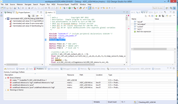

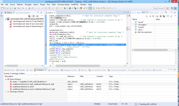

I'm unable to use the math operators such as pow and log, although I did include the "math.h" library. Kindly tell on where I'm going wrong.
I have attached the screenshots supporting the problems faced.

I think you should add math library in the Project Settings. Please see https://community.nxp.com/thread/485416
