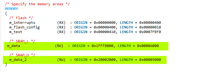

Hello
I use a large variable array this size is " uint16_t array [800][21].
So this leads to problems that  m_data overflowed by 3536 bytes.
I have to use this variable array. How to modify the "S32K1xx_flash.ld"?
Help me please.
** Processor: S32K144 with 64 KB SRAM
** Compiler: GNU C Compiler

MEMORY
/* Flash */
m_interrupts (RX) : ORIGIN = 0x00000000, LENGTH = 0x00000400
m_flash_config (RX) : ORIGIN = 0x00000400, LENGTH = 0x00000010
m_text (RX) : ORIGIN = 0x00000410, LENGTH = 0x0007FBF0
/* SRAM_L */
m_data (RW) : ORIGIN = 0x1FFF8000, LENGTH = 0x00008000
/* SRAM_U */
m_data_2 (RW) : ORIGIN = 0x20000000, LENGTH = 0x00007000

6,722 Views
jiri_kral
just increase m_data size and reduce m_data2 size - for example:
Jiri
6,722 Views
kwakd_y
Hi~
How much can I increase m_data?
Is m_data2 up to the area ???
6,721 Views
jiri_kral
it is up to you. You can even join m_data and m_data_2 to one section. In attachment is linker file with only one m_data section used full available RAM.
