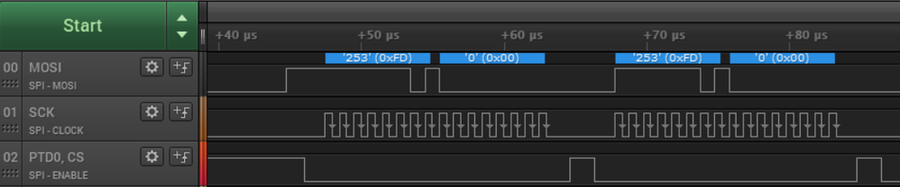

I tried to use SPI transfer with CS as GPIO. I'm performing following steps.
1. Making the CS LOW
2. Pushing to data in the FIFO
3. Making the CS HIGH
I'm able to transfer the data but my CS goit HIGH (Step 3) Far ahead of the transfer.
CS_LOW;
LPSPI0->TDR = LPSPI_TDR_DATA(n) ;
while((LPSPI0->SR & LPSPI_SR_TCF_MASK)>>LPSPI_SR_TCF_SHIFT==0) {}
CS_HIGH;

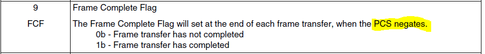

I tried waitng till
Even I tried to wait for the FCF flag to set. I don't see any change considering by frame length as 7+1 bits
but, surprisingly the TCF, FCF, WCF flag will set immeadiately after writing the data into the tranmit buffer though theCS still holds the LOW.
Kindly help in this regard,
Raju

Hello Raju,
I'm not able to reproduce this behavior.
I tested the S32K144_Project_LPSPI example from S32DS with this modification:
void LPSPI1_transmit_16bits (uint16_t send)
    while((LPSPI1->SR & LPSPI_SR_TDF_MASK)>>LPSPI_SR_TDF_SHIFT==0);
    /* Wait for Tx FIFO available */
    PTD-> PCOR |= (1 << 0); // CS LOW
    LPSPI1->TDR = send; /* Transmit data */
    while((LPSPI1->SR & LPSPI_SR_TCF_MASK)>>LPSPI_SR_TCF_SHIFT==0) {}
    LPSPI1->SR |= LPSPI_SR_TCF_MASK;
    PTD-> PSOR |= (1 << 0); // CS HIGH
And it works:
Could you share your test project?
Thank you,
BR, Daniel
