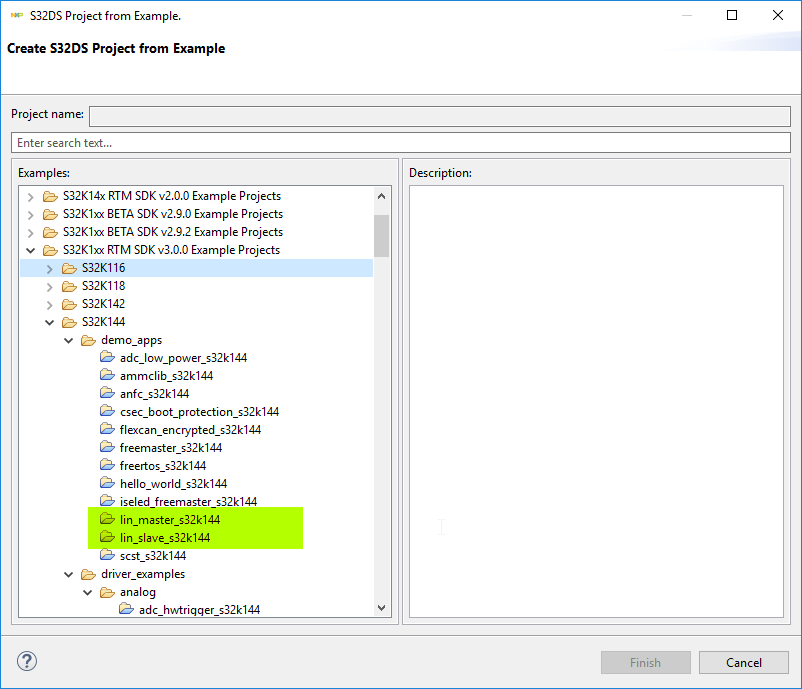

victor_song_171
Just like the title.
I want use lin model in s32k144 and via S32DS .
In S32DS, there is linstack model , but without manual document .how could startup with it ? And is there any document to introduce LIN function structure ?
Tags (4)
1,945 Views
jiri_kral
good starting point is SDK documentation - you can find it in c:\NXP\S32DS_ARM_v2018.R1\S32DS\S32SDK_S32K1xx_RTM_3.0.0\doc\html_S32K144\  folder. There is also SDK Example:
You may also find helpful this thread - https://community.nxp.com/thread/479473
Jiri
