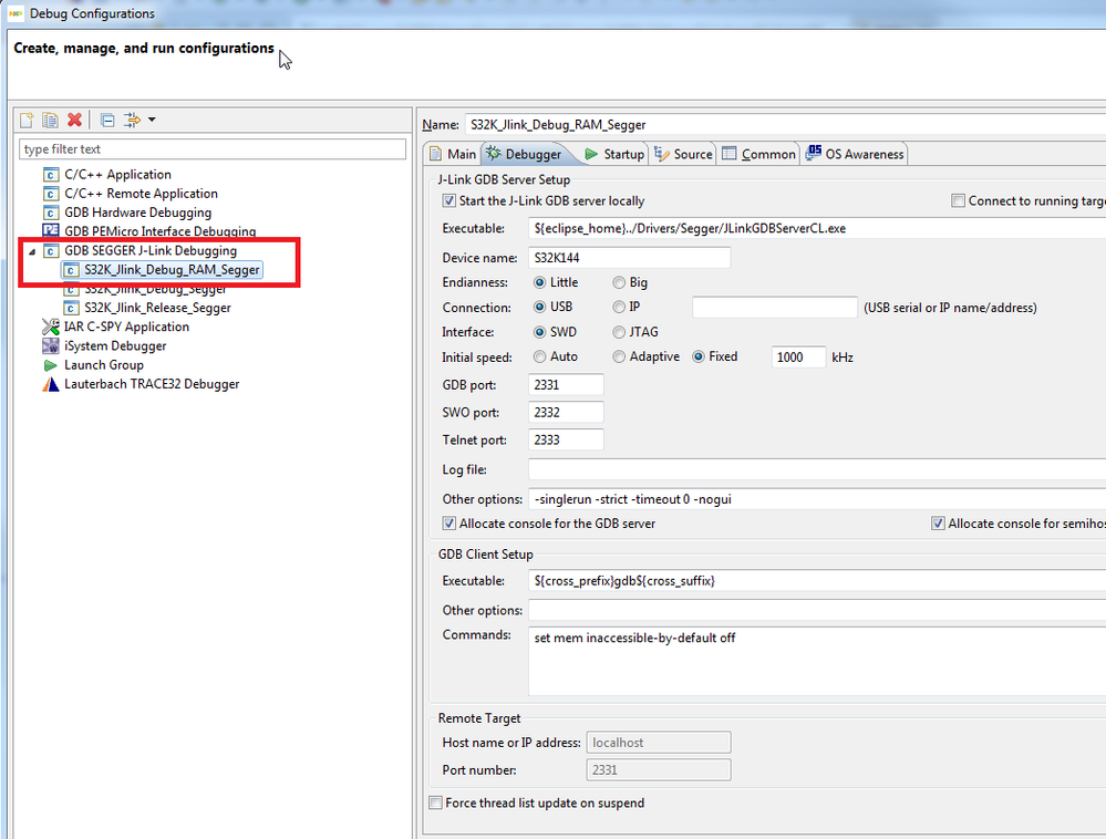

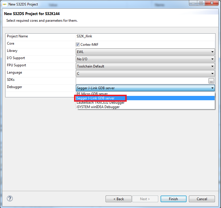

stanish
S32 Design Studio integrates Segger GDB server:
About J-Link GDB Server | SEGGER - The Embedded Experts
You  have to create a new project and select "Segger J-link GDB server"
or add and a new debug configuration into "GDB Segger J-Link Debugging" section into your existing project.
Hope it helps.
Stan
