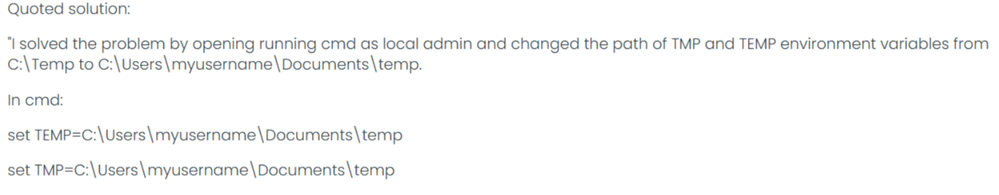

ddddddd
BUILD project find error
Cannot create temporary file in C:\Windows\: Permission denied
2,925 Views
jiri_kral
please move the temp folder into your user space:
2,903 Views
ddddddd
Sorry about that I set the path with admin but did not valid And I find C:\Windows\bootstat.dat file modify time update with project build
