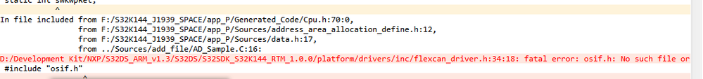

       Problem description:
       when only a few files in engineering, and compiled code amount is very small, compile won't appear any problems, when joined in the project many files, compiled code amount is larger, at compile time error.
      The console window displays the following error:
         The specific errors in the compilation of the project are shown below:
       Due to an error in the file is the underlying driver files, and software compilation, small amount of code without error, should be the problem of S32DS software itself, therefore, please help to give a solution, thank you.

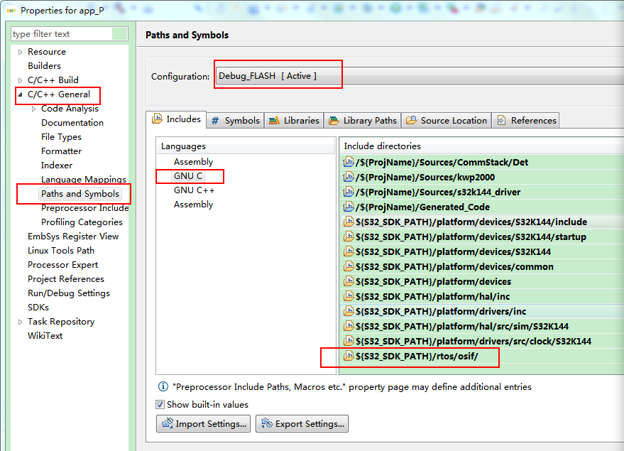

stanish
Please make sure the file exists and there is an include path defined in your project to the folder
"${S32_SDK_PATH}/rtos/osif/"
Stan
3,089 Views

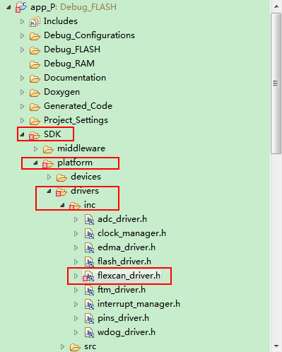

jinshuaixu
Contributor V
Hi,Sliva
        firstly,thank you for you response .l am very sad that you advise is not use .the way that you provide l have tested before l ask question. is there anyother solution ? please give me more helping, l am very worry.the time left me to resolve the question is not much.

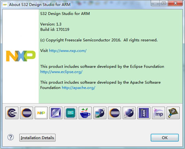

martin_kovar
could you please write me which version of S32DS you use and which version of SDK you use?
Could you please share the project you are not able to compile?
Martin
3,089 Views
jinshuaixu
Contributor V
HI Kovar
      thank you for you respone firstly, l can not upload the project ,because the project is secure in my company.the version of my software is below
