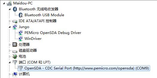

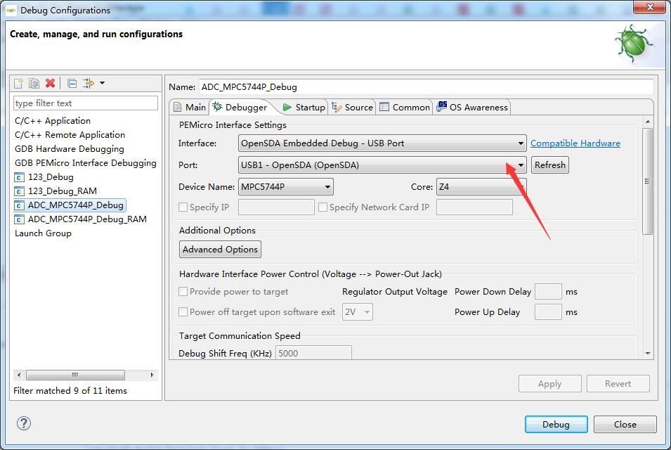

The development board is the official DEVKIT-MPC5744P. The development environment is S32DS. The drivers for opensda are also installed properly. The following figure will appear when downloading.
The latest firmware has been updated from the PE official website.
Driven as shown below, can be identified normally, really can not figure out what causes the cause.

please look at this doc - https://community.nxp.com/docs/DOC-340263
and update your OpenSDA firmware.
Hope it helps.
