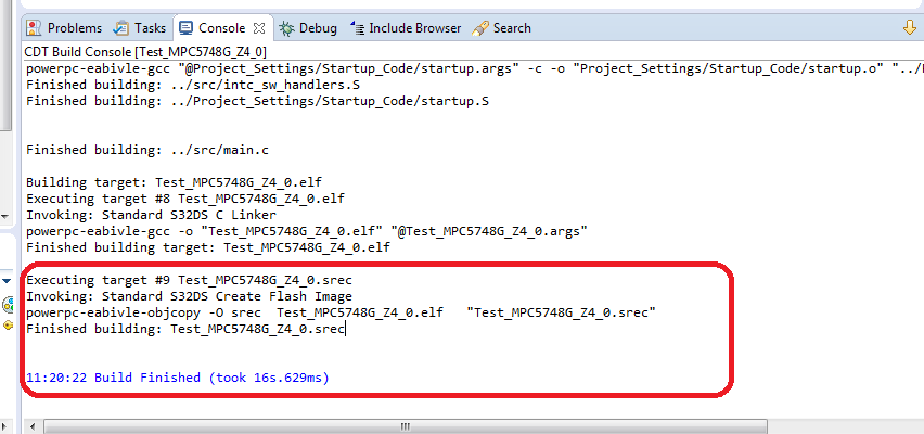

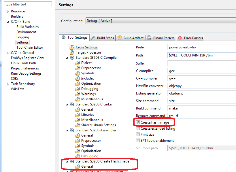

Flash image (srec) is created using powerpc-eabivle-objcopy.exe
When "Create flash image" option is enabled (tick it and click on Apply -> new Standard S32DS Create Flash Image settings node appears in the Tools settings)  you should see its output in the build console after the successful build:
Is there any error visible in the build console?

Can you paste here the console output?

jinjingyang
Customer checked the console, there is no such message. But after adding the "powerpc-eabivle-objcopy.exe -O srec" command, they are able to generate s19 file. Thank you for your help.
