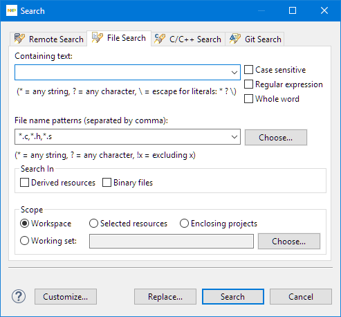

Hello,NXP Engineer.
When i use S32DS.Alway can't find something such function or other in the project.
Is that have find in file features?
If this IDE supporter features about find in file,can you show me how to use it.tks!

BlackNight
It is here:
I hope this helps,
Erich

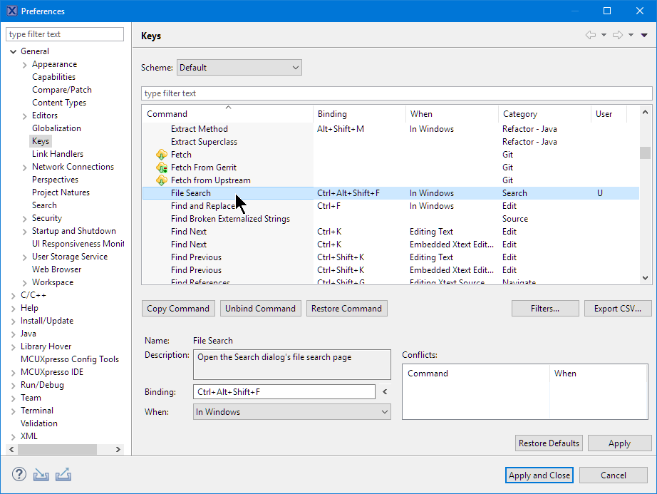

kemingkai
Erich,Thank for your helps.Now I can positioning the function and i have a new question.
Do you know how to setting hot key for find in file.I want to use it after press ‘Ctrl’+‘F’.

BlackNight
Have a quick read at 10 Best Eclipse Shortcuts | MCU on Eclipse
You can assign shortcuts to everything you want. The one you are looking for is this one:
I hope this helps,
Erich
