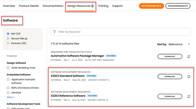

hi,
i installed S32 on my host and i don't see packages  in the menu "S32DS extensions and updates"
i want to install S32K3 sdk
i think my company have blocked something
My question is how test is my connection  download is correct  ?
1,391 Views
lukaszadrapa
Hi @monk_65
please go to:
https://www.nxp.com/products/processors-and-microcontrollers/s32-automotive-platform/s32k-auto-gener...
And then click on Download in Software section:
Then follow this Getting Started guide:
https://www.nxp.com/document/guide/getting-started-with-the-real-time-drivers-rtd:GS-AUTOMOTIVE-RTD
Also each SW package contains Release Notes pdf file. I recommend to check Installation section for details and requirements.
Lukas
