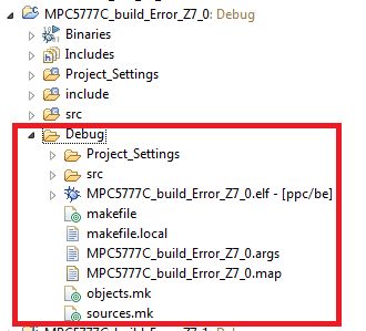

stanish
Can you possibly attach the zipped output folder e.g. Debug
This might help us to find a root cause since the console messages doesn't clearly indicate what is the problem.
Stan

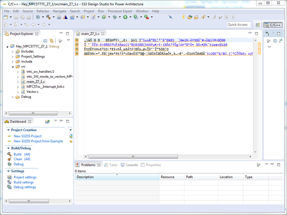

Unfortunately I cannot build your project since I see some "garbage" characters in all your C source files.
I suspect this could be related to a character encoding page setup or something has modified the content of your source .c  files. Can you check if these characters are visible on your side?

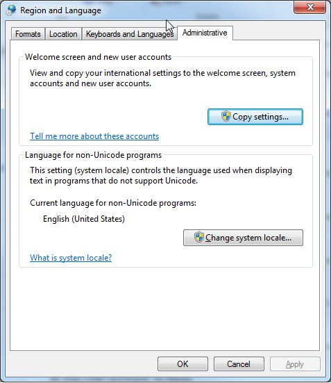

What is your "Region and language setup" on your machine?
Can you possibly try to temporarily switch it to English (if it is different) and then start S32DS, create a new project in the empty workspace and try to build it?

alphafeely
I am so sorry. the correct zipped project has been attached. thanks
