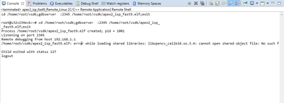

2. I tried building and running apex2_isp_fast9 in my S32V234 board. Got this below error:
The error is consistent with both S32 V3.2 and S32DS V3.4.  Ping between PC and board is successful but library files are missing. Quite not sure how,

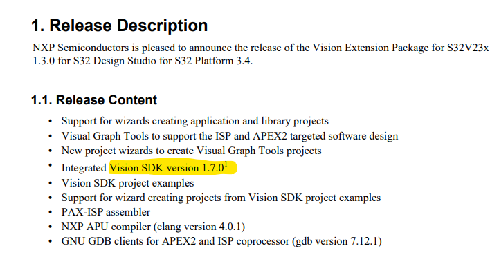

The image you provided shows the Vision Extension Package for S32V23x v1.3. This package includes an integrated version of the Vision SDK. To find the version, you could look to the S32V23x_Extension_Package_Release_Notes.pdf. This is located at 'C:/NXP/S32DS.3.4/Release_Notes/S32V23x_Extension_Package_Release_Notes.pdf'
The Vision SDK version is listed in the Release Content section:
Each version contained some bug fixes and other improvements. In your case, we see one of the example projects was removed. There will be no further development efforts in S32 Design Studio to support newer versions of the Vision SDK nor are there plans to provide any patches/updates to existing versions.

On the example "apex2_isp_fast9", I've found most issues with running the examples out of the box will be related to the versions of the Vision SDK and the Linux BSP. These must be in sync for the examples to work correctly. For example, the most recent version of the Vision SDK that is available for integration with S32 Design Studio is RTM 1.7.0. This version of the Vision SDK is compatible with the Linux BSP 23.0. So you should not use any of the newer versions of the Linux BSP. Please check if you have these versions in sync and if not try to download the compatible versions and try this example again.
Hope that helps.
