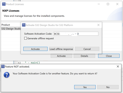

       anyone can tell me what happend below? and are there any documentations about the DS licence and activation usage? thx a lot~

I checked your account. It seems this license is setup to work for both S32 Design Studio 3.4 and 3.5. I also see you only have one license. If you would like to have 100 licenses, you can entitle your account for a S32DS 3.5-only license here:
https://www.nxp.com/webapp/swlicensing/sso/downloadSoftware.sp?catid=S32DS-3-5
Otherwise, you could select Yes on that dialog window and then try to activate again and it should work.
Mike

Fidel
ok, thanks a lot~

Fidel
    got it ,thanks a lot, and if there are any documentations about this?

mikedoidge
There is no documentation for this.
The link I just provided to you is the same as you will find on the S32 Design Studio for S32 Platform product page. https://www.nxp.com/design/software/development-software/s32-design-studio-ide/s32-design-studio-for...
This is the method which we expect most users to use to obtain a license for S32 Design Studio.
