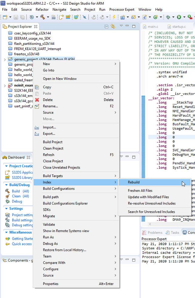

I am compiling the MCAL Sample Application for S32K118 on S32DS using the gcc-6.3. I have no issues with the compiling process. The console output works perfectly fine. However, I get many errors stating various Macros and variables could not be resolved. This is probably an indexing issue, but it gets a little annoying and I cannot use "Open Declaration" functionality since they could not be resolved.
How can I fix this issue?

sorry for delay. What about Index -> Rebuild (right click on project name -> Index -> Rebuild)  - does it help?

No, nothing changes.
By the way, this issue is not there for example projects. Only when I import the MCAL sample application, and play around with it I have these issues. The compiler can find the references, but S32 DS keeps raising errors for not finding references to variables.
