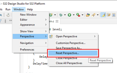

shanlan123
click IVT button in S32DS3.4,but nothing show。help me

mikedoidge
Sometimes in Eclipse, when opening a perspective, it does not load properly. This can be easily solved.
Please try this:
Window -> Perspective -> Reset Perspective...
Mike
