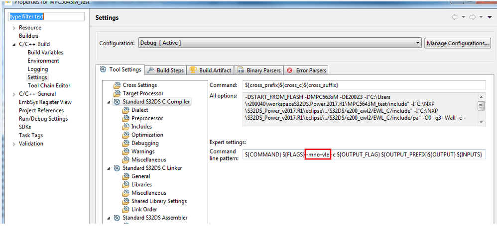

Using S32DS, how to force non-vle build for the entire project (MPC5644A).
The default is vle build. Removing "powerpc-eabivle-" generates error.

please open project properties and add -mno-vle option into Compiler Command line pattern.
When you will download the project into the microcontroller please also check, if you have disabled VLE in RCHW.
Martin

Hi Martin,
Thanks for your support, since I use sons script instead of S32 default compile, so I add -mno-vle in cc flag, but it shows multiple error  like unrecognized opcode: `e_add16i'/`e_rlwinm'/`e_b'/`se_rfi'/`se_illegal'. Do you have any idea how to deal with this?
