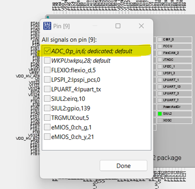

I have created the application project in s32k324. I tried to configure the PTE11 pi as an ADC. But in S32DS pin configuration showing default selection. If i select this pin means it doesn't generate the pin configuration in Siul2_Port_Ip_Cfg.h file. Kindly guide me to configure the ADC pin.

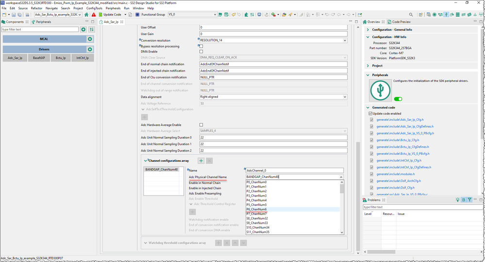

You don't need to select those default selection pins in Pins tool.(It will not generate the pin configuration in Siul2_Port_Ip_Cfg.h file)
Please select Adc Physical Channel Name in Peripheral tool.
