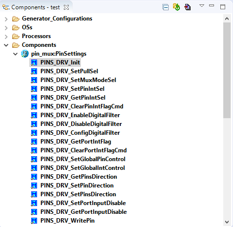

I'm moving form S32 2.2 to 3.4
in the 2.2 version when using processor expert it would show a function list which you could drag and drop into the code, with the configuration names prefilled.
does this exist in version 3.4? if so how do i view this
example of what i can see in version 2.2
S32 2.2 processor expertS32 2.2 processor expert

Hello @fk1,
Unfortunately, that functionality was not reproduced in the new S32 Configuration Tools. It was quite a useful feature.

Without this functionality, how does this version call generated functions?
3,545 Views
mikedoidge
You will have to add them using the traditional method. If you are looking for some tool to place the calls into your code, there isn't one.
There are many example projects provided with the SDKs/RTDs which demonstrate the usage of each of the functions.
