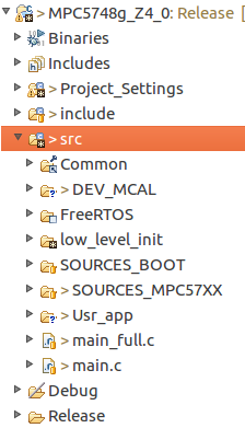

Hi, I'm using S32 studio to debug MPC5748G, when set up the debugger on  dev-kit mpc5748g, the program can run but the console show it can not find main.c, but I  see the path is correct, the main.c is under the src/ .
Does anyone know how to set the IDE ?

You seems to be using Linux version of the tool.
Could you possibly try to clean the project first and rebuild it. I suspect the original elf perhaps refers to a different path to  main.c.
