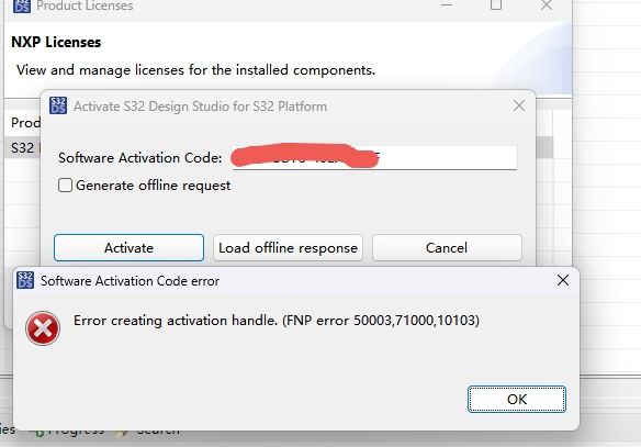

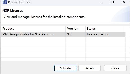

Originally, S32DS could be used normally. Perhaps due to reinstalling the system, when using it again, there was a prompt that the license missing.

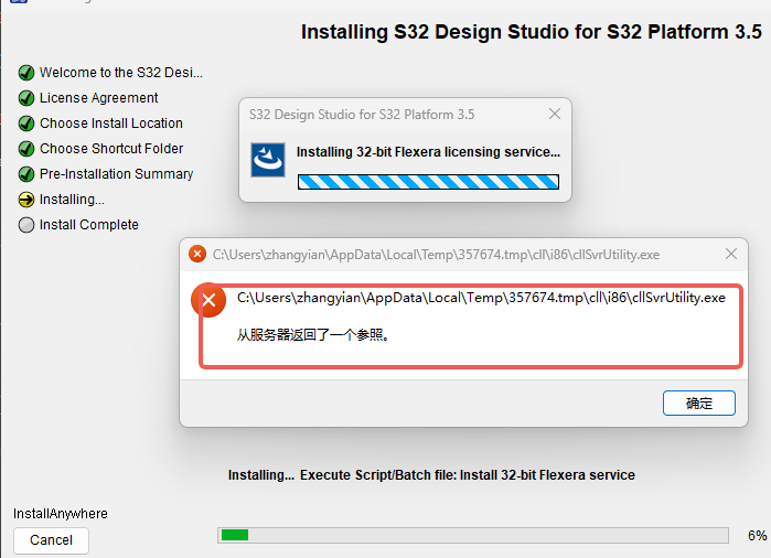

Then I uninstalled and reinstalled it, and used the license received in the previous email to activate it online. However, the following problem occurred. When I installed it, I opened it in the administrator mode, but still could not solve the problem.

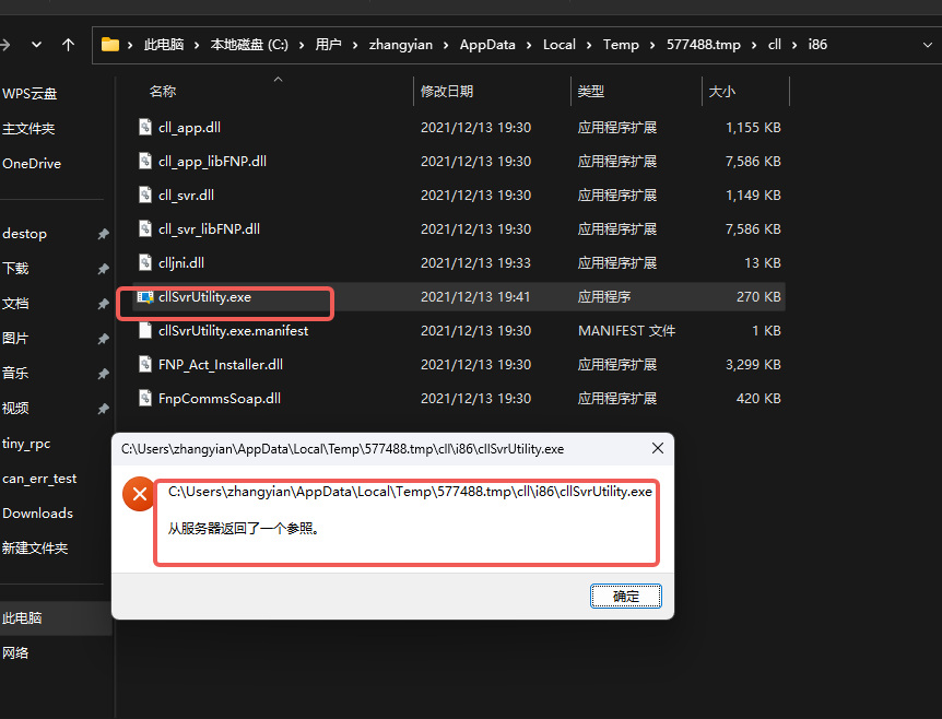

After entering the corresponding folder of the problem, running cllSvrUtility.exe still cannot run.

you can try to backup and delete content of c:\ProgramData\FLEXnet\ folder. The folder is by default hidden.
Anyway, are you using the correct activation key? The right one ends with -2ECF
