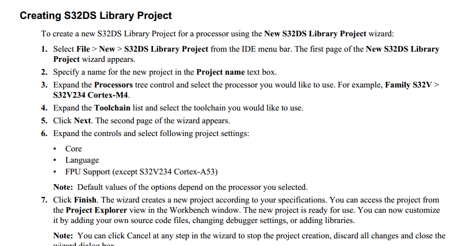

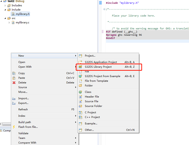

With S32 DS development,I need encrypt some .c /.h files .But  I don't how to complete.

S32DS itself cannot encrypt any files. You must use some third party tools for this purpose.

But  what can the S32DS Library Project do?I think it can encrypt the .c or .h.

2,666 Views
jiri_kral
the library project create static library archive - typicaly libmy_lib.a. You can link functions stored in library by other projects.
Anyway - what you mean by "encrypt"?
