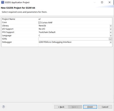

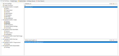

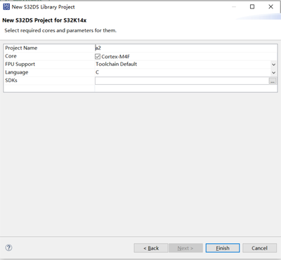

When I call the static link library file (.a) created by myself, there is an error when compiling. I would like to ask the cause of this error. And how to solve it?

please make sure the compiler options for library and app match.

I make sure the library and the application's compiler options match.

The compiler options @stanish was referring to would be found in the 'Standard S32DS C Compiler' section of the Tool Settings menu (visible in the 2nd image you shared on the start of this thread).
