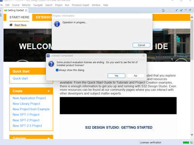

S32 Design Studio for Power Architecture version 2.1 doesn't working also I tried to cancel operation but it doesn't move.
The status display in the lower right corner keeps saying "License verification" and doesn't proceed to the next step.

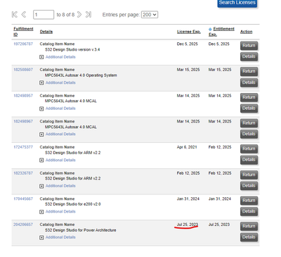

My license expiration date is July 25, 2023.

Hi, @JunSeoHan ,
I have extended your license through end of December 2027.
Please refresh or re-activate your installation.
Please let me know if you are facing any issue.
