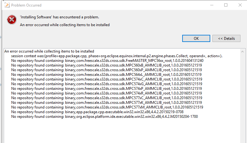

Hello, when I try to install some plugins from Eclipse Marketplace, problem occurs.
As the figure blew shows:
How can I slove this problem?
Thanks your help.
Hu

Hello Hu,
Could you please indicate which apps have you installed from the Marketplace?
It seems S32DS installation has been corrupted.
I'd recommend you to reinstall it.
Stan

Hello Stan,
It occurred when I try to install the " Eclipse Color Theme 1.0.0" from the Marketplace.
But it seems other apps also can not install.
Reinstall the S32DS didn't make any difference.
The S32DS V1.0 didn't have this problem, but V1.1 have.
I found a reference: (Eclipse SDK update error) An error occur while collecting items to be installed - Stack Overflow
But I still can not solve this problem.
Do you have any idea?
Thanks!
