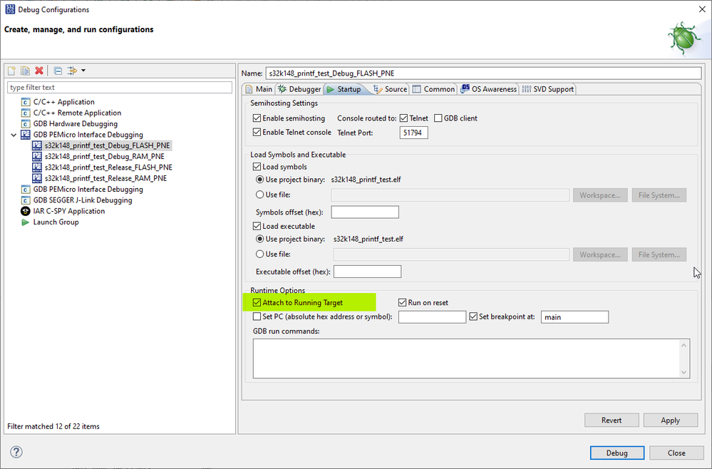

jiri_kral
try to attach to running target when you power cycle your board. Your program probably ends in some kind of exception:
Jiri

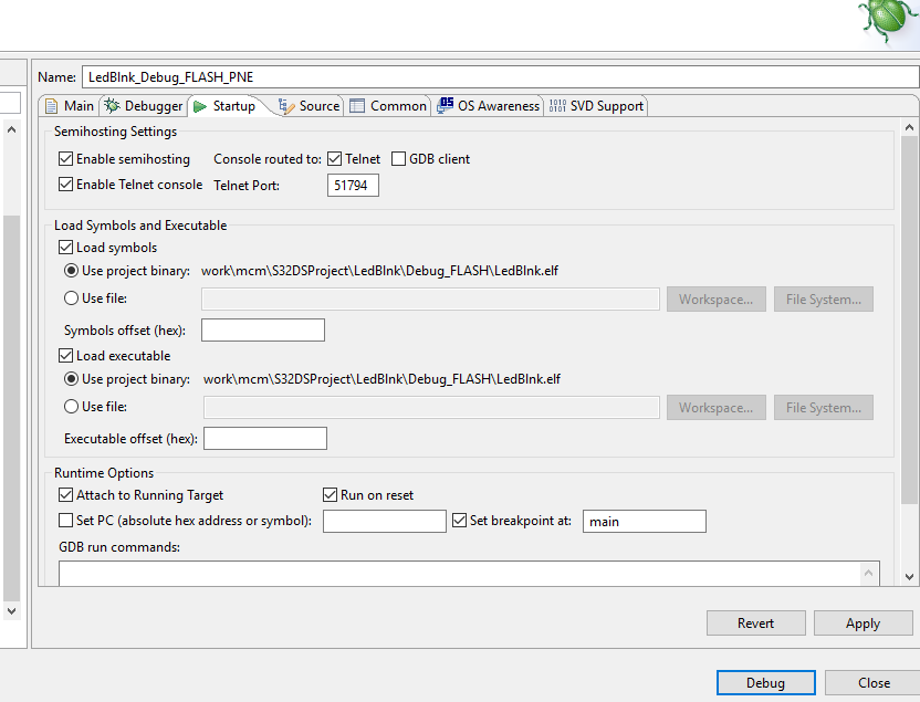

Dear Jiri,
I try to run with "Attach to Running Target" as below:
And always got error as below:
Can you advise? Could be some IT issue on my company PC firewall?
Thanks and best regards
He Wei

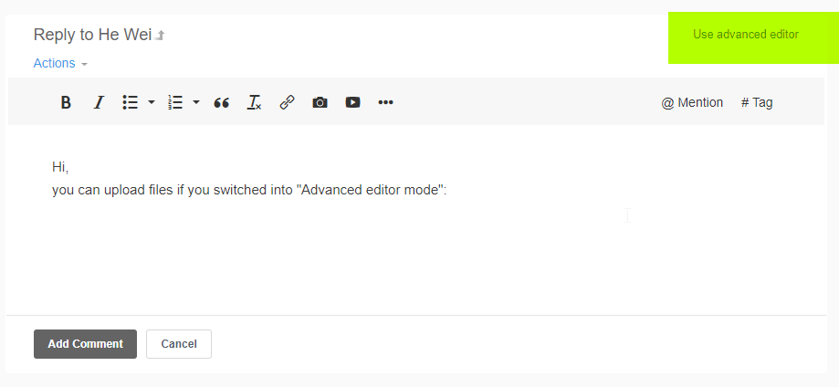

wei_w_he
Dear Jiri,
How to upload a zip file here? (I only see image and video upload..)
I noticed the "good" firmware S32K116_EVB_JumpStart_Firmware.elf (download from NXP) is built based on S32K116 configuration but it is working fine in my K118 board. i.e. after power down and up, the program will resume.
For my project, I always configure as S32K118_64.
He Wei
8,322件の閲覧回数
jiri_kral
you can upload files if you switch into "Advanced editor mode":
Jiri

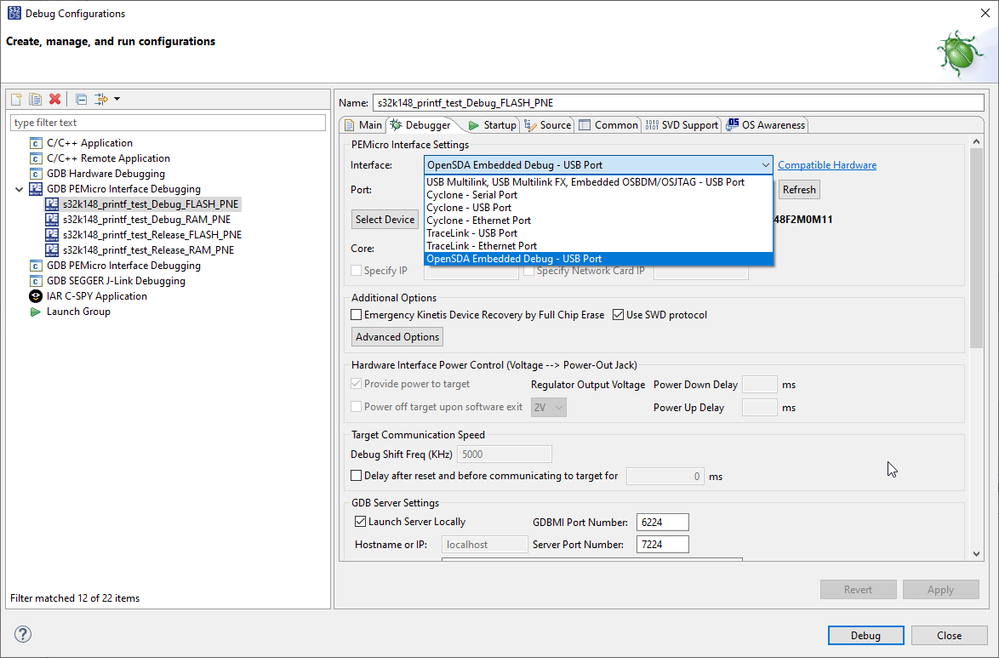

jiri_kral
You may find helpful this thread - SDK problem in S32 Design Studio for ARM 2.2
You can compile your project as a Flash target or RAM target. Flash target is flashed into Program flash space, RAM target runs from RAM only.
From HW perspective - there is no difference between Debug and Release target. Debug .elf file contains symbols and path to sources. Release .elf file is without this information and debug session shows only disassembled code.
Well - to be honest - I never used Run As option - it looks that this can be used with Segger J-Link only.
Best way how to start debug session is open Debug configurations, choose your debug probe and select debug config:
Hope this helps.
