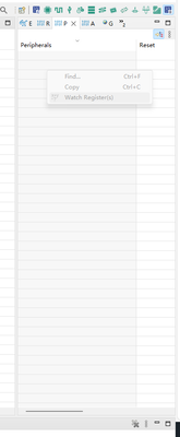

mikedoidge
To setup the watch register, first start a debug session, then go to the Peripherals view and right-click on the desired register and select 'Watch Registers(s)'.
Next, go to the Watch registers view and see the values change within the register as you step through the code.

kxliu
Hello, my S32DS Peripheral Registers  why is the right-click option grayed out in my interface
