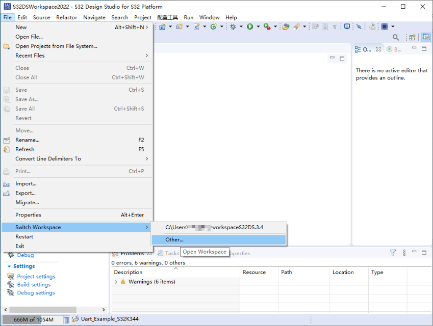

Hello Team,
We installed S32 Design Studio by following the installation guide provided. But it's throwing error saying (Project location can't contain symbol:" ") while we try to create a new project or try to run example projects. The project path doesn't contain any symbols. Please find the attachment.
We have installed S32 DS in two different PCs with the same activation code. It works fine in one PC and the other one throws this error. Does it requires different activation code for different system? . If not , can you help us to resolve the issue.

I have found solutions.
solution1:
Open your S32DS's install dir, and the examples are inside there.
For example, my S32DS's install dir is : C:\NXP\S32DS.3.4\S32DS\software\PlatformSDK_S32K3_2021_10\SW32K3_RTD_4_4_1_0_0_D2110
Solution2:
Change your workspace path: File -> Switch Workspace -> Other...
4,857 Views
jiri_kral
please use workspace name and path to workspace without spaces (you can replace space for example by _ character).
Jiri
