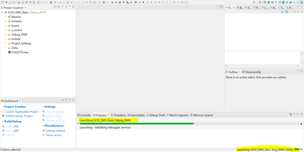

Hello team,
           I am working on the customer project in S32Z27X Soc. When trying to do ddr training it says that Serial parameter error. So First I thought I would do the example binary flashing in SRAM using the S32 debug probe but when I tried to flash it hangs at 52%.
I can able to read the board details but can't flash,
Could you please help me to solve this issue?Flashing Hangs..pngBoard_Status.JPG

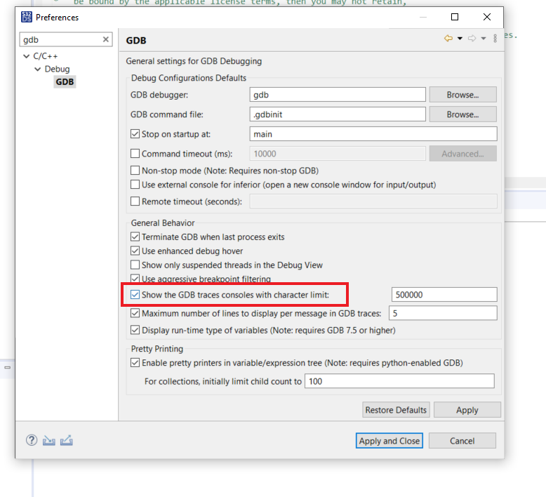

Frist you would need to enable the GDB trace using enabling the GDB trace from the properties:
You can view the log as from the Gdb traces options as below :
Please can you attach the GDB trace and we will follow-up with you for the issue.

Thanks for the response. When I tried DDR training board was in debug mode.
So I tried to flash the RAM using an s32 probe.
 But it struck in 52%.
is there any chance that because of S32 debug probe issue?

We are seeing the following message on your S32DS:
We understand that this message explains that S32DS is still trying to load the RTD. Can you verify if after S32DS loads the SDK the problem persists?
Also, can you verify if the "Test connection" provides any information on regards of the debug link:
