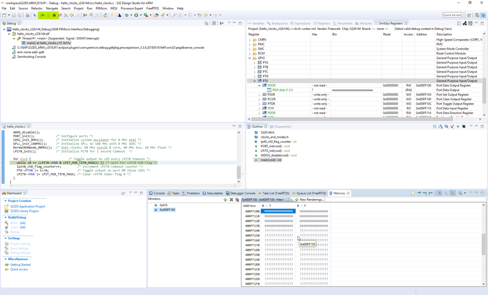

Hi ,
I using S32 DS, i would check the value of register, e.g  PTE-> PDOR in EmbSys Register windows. but there is no value shown, why?
and i check it in memory "0x400ff100" , it shows "?", what is the problem?
2,407 Views
jiri_kral
you probably add the Memory view address when the part was running. As I mentioned in another thread - S32DS doesn't allow runtime debugging. You can check your memory/registers and so on only when MCU is stopped:
