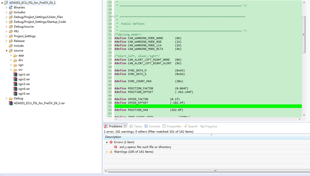

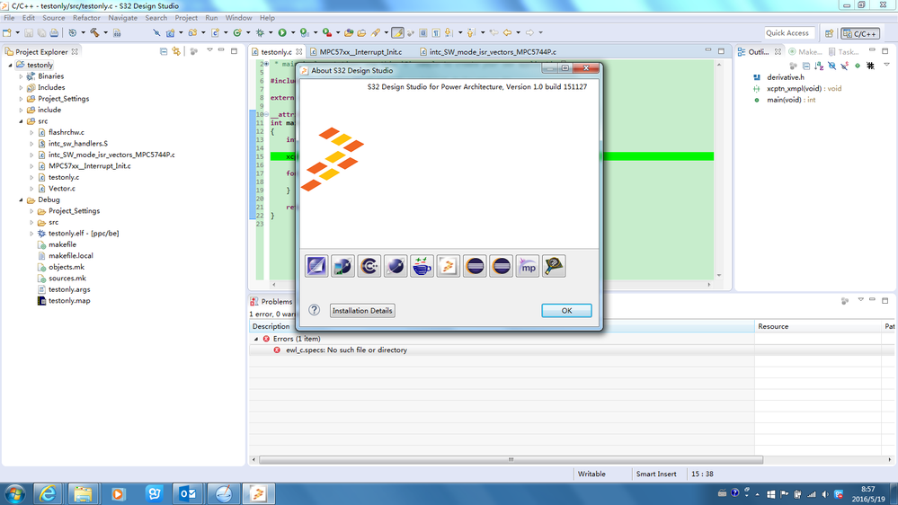

The same project is ok in my colleague's computer. But in my computer, it reports an err " ewl_c.specs: No such file or directory"
can anyone help me to solve it? Thank you very much!

have you tried to "Clean" and rebuild your project?
Which version+Build number does your workmate has? The version you have is the first official release available.
I suspect your colleague uses a non-official release and therefore you might experience some compatibility issues.
I'd encourage you to use official release in order to avoid such a problems.
Stan

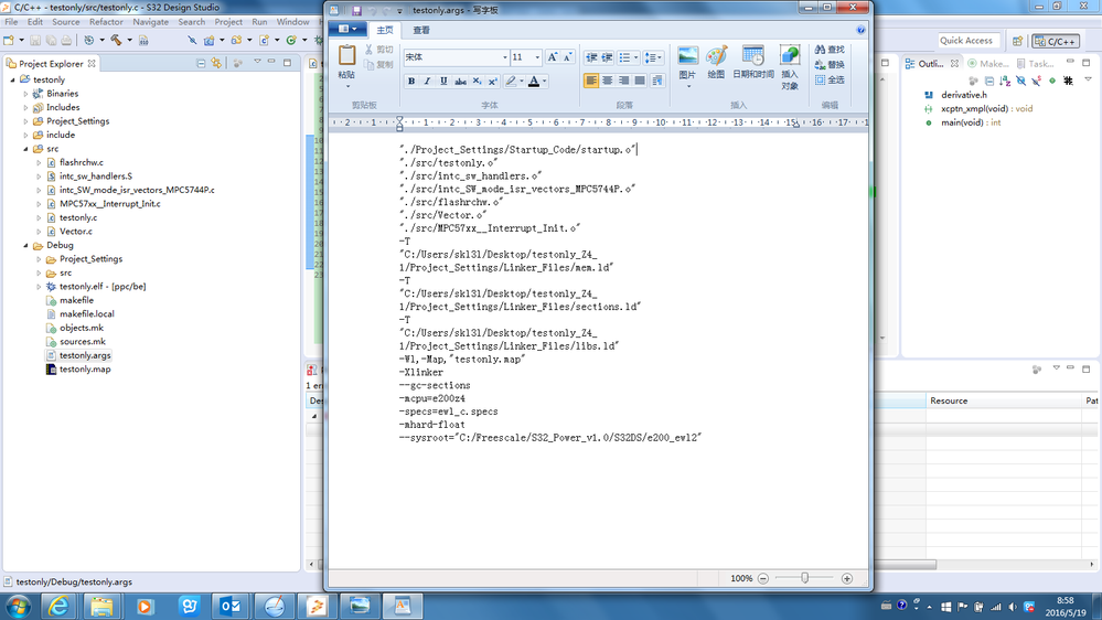

Building file: ../source/srv/sys/osv/osv.c
Executing target #1 ../source/srv/sys/osv/osv.c
Invoking: Standard S32DS C Compiler
powerpc-eabivle-gcc "@source/srv/sys/osv/osv.args" -MMD -MP -MF"source/srv/sys/osv/osv.d" -MT"source/srv/sys/osv/osv.o" -c -o "source/srv/sys/osv/osv.o" "../source/srv/sys/osv/osv.c"
powerpc-eabivle-gcc.exe: fatal error: C:/Freescale/S32_Power_v1.0/S32DS/e200_ewl2/lib/ewl_c.specs: attempt to rename spec 'cpp_unique_options' to already defined spec 'old_cpp_unique_options'
compilation terminated.
make: *** [source/srv/sys/osv/osv.o] Error 1
This is caused by different versions of S32. My workmate has low version of S32, mine is high version(you can see in the picture above). Every time i copy his project to my computer, it reports the err above, could you help me for this? Thank you very much!

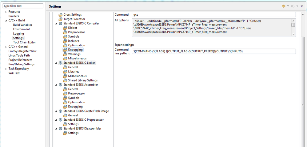

martin_kovar

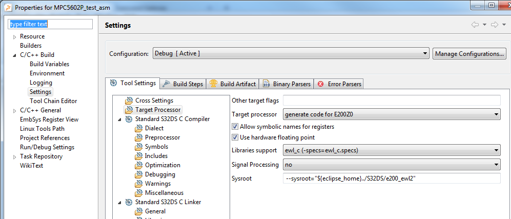

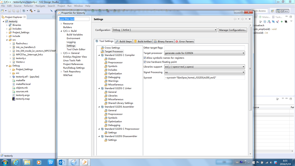

could you please share Compiler, Linker and Assembler settings (see following screen)?
Martin
5,797 Views

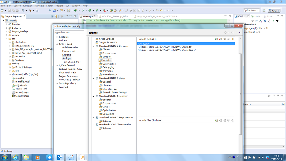

fyw
thank you for you both!
It seems suddenly that every project in my computer has the same problem(even the compiled ok program before and the new empty project)

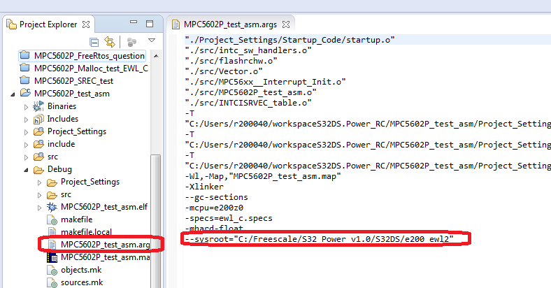

stanish

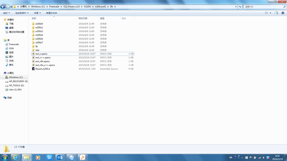

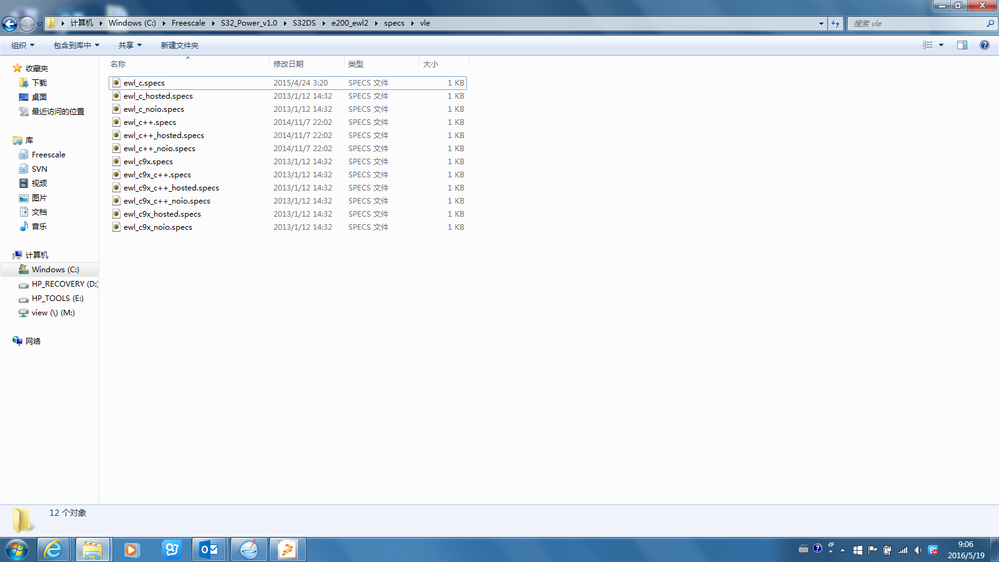

Could you please check if --sysroot path matches with your environment (see the screenshot below) and if your S32DS directory includes this folder/file too (perhaps the installation of S32DS was not completed).
Stan
