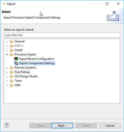

Is there a way to regenerate the clock tree from a processor expert generated code?
We have multiple projects with different clock configurations but clock configuration spreadsheets used for each is not collocated.  Trying to do a manual match will take ages.
It would be nice to have the ability to regenerate the clock tree diagram from the processor expert and collocate it with the project. Is there a way to do this?

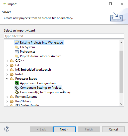

you can Export/Import Processor expert component settings. On main menu bar click to File->Export (Import):
Hope it helps.
