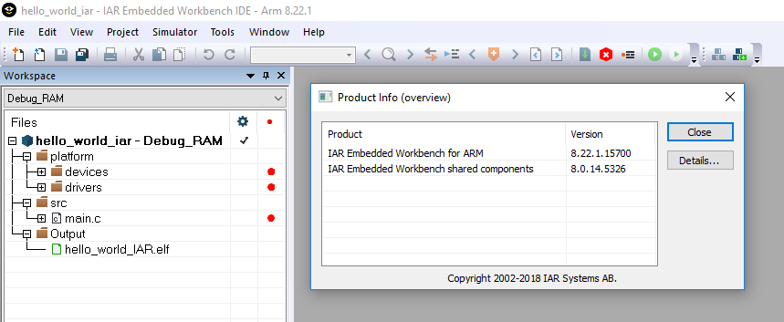

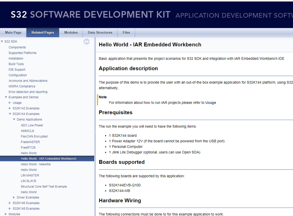

Hi Kate,
Which specific example do you mean?
AFAIK the most examples are available only for Standard s32DS GCC toolchain.
Anyway there is one example - Hello World for IAR EWARM
This one you can directly open in IAR EWARM (see below).
Hope it helps...
