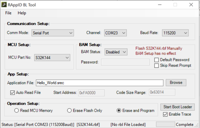

PrabhuNex
hi @mikedoidge i am using Uart bootloader. can you please tell me, what Baudrate is configured in the file you shared.
As i am getting error " loss communication with CCP MCU".

PrabhuNex
hi @mikedoidge i have checked with the same Baudrate but it didn't work. i have attached the image in my previous reply for the error.
is there some other way i can solve this issue, as i am selecting s32k144 as the MCU as there is no s32k116 available in the dropdown.

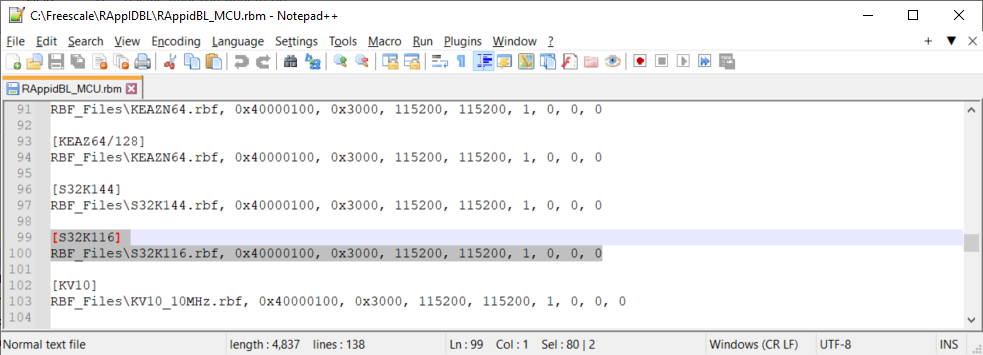

mikedoidge
Hello @PrabhuNex,
As detailed in the RAppidBL_UserManual.pdf, you can modify the RAppidBL_MCU.rbm file to add the S32K116.rbf file.
After you change the file and launch the RAppID_BL.exe, you will see the new part listed in the GUI.
