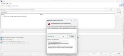

i tried to install lauterbach Trace32 debugger plug-in into S32 Design Studio for Power Architecture Version 2017.R1.
However, i unable to read repository at http://www.lauterbach.com/eclipse
if i used S32 Design Studio for Power Architecture Version 2.1 instead of S32 Design Studio for Power Architecture Version 2017.R1, i can install lauterbach Trace32 debugger.
but i have to used S32 Design Studio for Power Architecture Version 2017.R1
Can I get some advice to resolve this problem??

is there some error message when you try to install Lauterbach plugin?

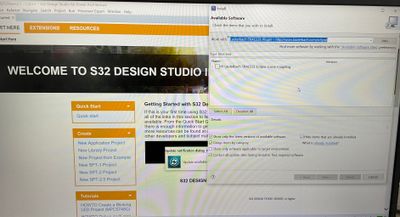

Jang123
If I used ver.2017 R1, I receive follow error
If I used Ver 2.1 I can install them like follow image
i don’t know diffrence between ver 2017 and ver 2.1

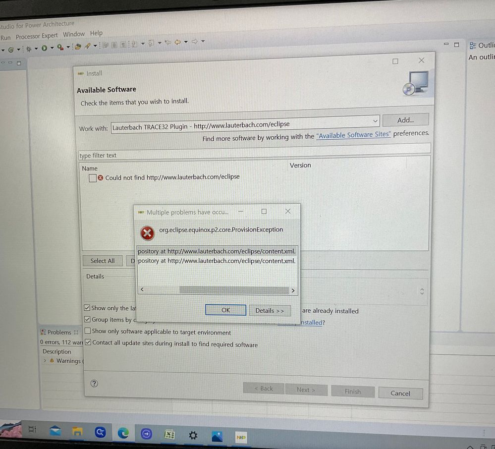

Jang123
IMG_0258.jpegIMG_0258.jpegi received error message "org.eclipse.equinox.p2.core.ProvisionException\\unable to read repository at http://www.lauterbach.com/eclipse/content.xml." when i try to install them

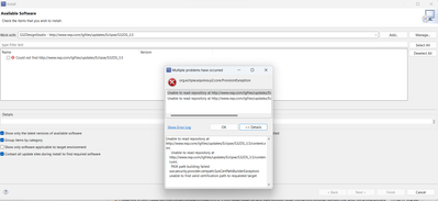

krishnaraomane1
I am also seeing same problem when trying to add plugins for lauterbach even with nxp Websites observed same errors snapshots are as follows

jiri_kral
this issue is probably caused by your company IT/Network policy. Please contact your local IT.
