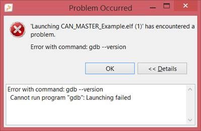

I'm trying to examine the CAN-FD robustness and operation using the S32K Freedom boards and using the design studio.
While other examples can be compiled and ran in the boards freely, the CAN-FD Master/Slave do compile but I get an Error when I try to run/debug it.
When I try to Run as S32DS C/C++ Application (with Debug_RAM or Debug_FLASH) I get:169655_169655.jpgError message 1.jpg
When I try to Debug as S32DS C/C++ Application with GDB (Debug_RAM or Debug_FLASH) I get:
I installed GDB on my windows but not sure how to connect it to the project.

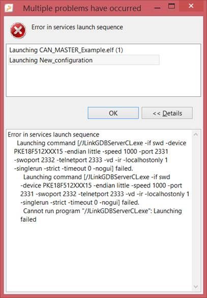

When I try to Debug as S32DS C/C++ Application with JLINK (Debug_RAM or Debug_FLASH) I get:

Hello IIan,
Which version of S32DS are you using?
I'd recommend you to download the latest release:S32 Design Studio for ARM v1.3 (Windows/Linux) released!
According to the screenshots this seem like a debug configuration issue.
1) Do not use menu "Run" to load the project: MPC5744P running problem  use "Debug" instead
2) make sure your P&E/ Segger GDB debug configuration is correct and complete:
e.g. Segger configuration seems to have wrong -device PKE18F... set (I assume you are targeting S32K144)
I'd recommend you to create a dummy project and compare its debug configuration with an example one.
 P&E GDB error message indicates there might be missing some information in debug configuration please check highlighted fields:
