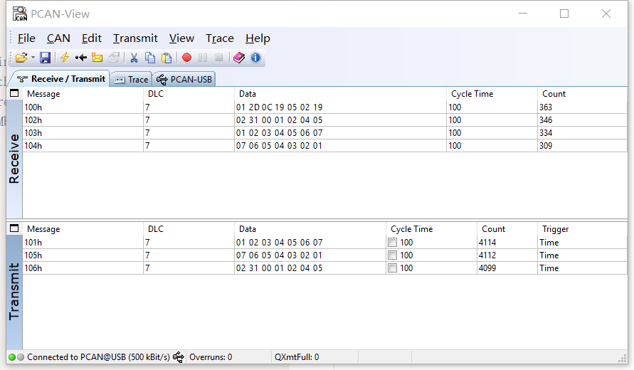

I have a problem when I build my project using S32DS.I want to use the FlexCAN module to receive multiple data and process the messages in the interrupt,but I'm failed.The ProcessorExpert only provide the following function prototypes which seems to be useful.

But when I tested my code, there were some bugs.Here's my test code.

The result is an error as shown below.
The expected result is that when the chip receives the ID101 data, it should send the ID101 data back with ID102.The result was a mess.The ID102 returns the data of ID106 and ID103 returns the ID101's data.
I want to know how this problem occurs, how to deal with it, what should be the correct way to use interrupt processing to receive messages?

The problem has been solved,my code logic has a problem.
FLEXCAN_DRV_InstallEventCallback(INST_CANCOM1, Callback,data_buf_struct);
It will always pass the last buff to the callback function.
