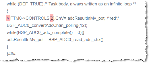

Using S32K144(WITHOUT SDK) I would like to update the value of the pwm[FTM0_CH0] duty cycle from the output of ADC0
...I'm able to read the value of the ADC using software trigger and confirm its operation using Real Time Expressions. However, I'm not able to update the value of the duty cycle with the value of the adc using the command:

while (DEF_TRUE) /* Task body, always written as an infinite loop */
// FTM0->CONTROLS[2].CnV= adcResultInMv_pot; /*red*/
BSP_ADC0_convertAdcChan_polling(12);
while(BSP_ADC0_adc_complete()==0){}
adcResultInMv_pot = BSP_ADC0_read_adc_chx();

Would you please confirm which channel you want to update.(Channel 0 or Channel 2?)
Robin
2,748 Views
huda_abdalla
channel 0,I commented this line because not using it
2,748 Views
Robin_Shen
But I didn't found where you change duty of FTM0_CH0.
During debug, does the FTM counter increasing?
Please check the value of FTM0_C0SC\ PORT_PCRn
Robin
