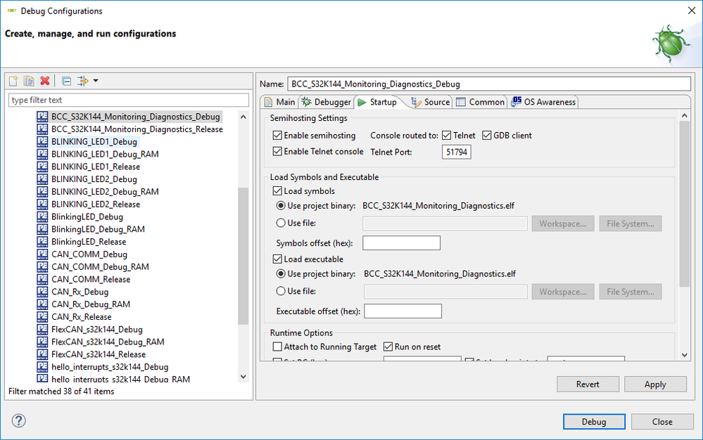

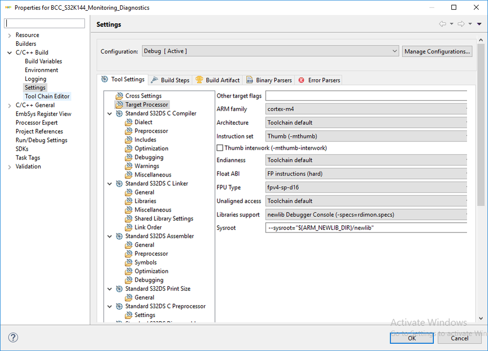

 I want to print it on the Debugger Console constantly,there are printf statements which prints on UART, unlike on Teraterm or Putty just once (via. UART), but I'm not able to print basic command  [printf("Hello\n");] ; I did made the changes in the settings from ewl_c no I/O to newlib Debugger Console,yet I'm not able to print. Kindly help me in this regard.
Thank you.

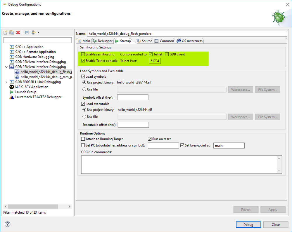

I'd suggest you to check if debug configuration has enabled semihosting:
Please check the thread below for more details:
S32K and printf() implementation
Hope it helps.
Stan

Hello Stanislav,
I tried it, yet I'm not getting the printf statements on console, Kindly tell where I'm going wrong.
Thank you.

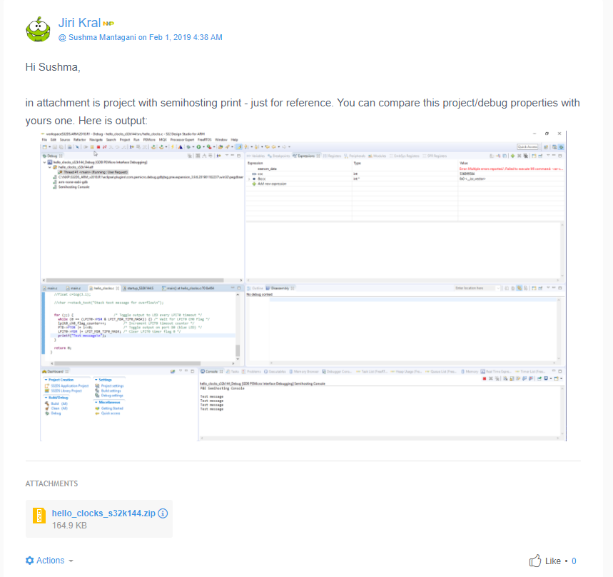

jiri_kral
Hi Sushma,
in attachment is project with semihosting print - just for reference. You can compare this project/debug properties with yours one. Here is output:

sushma
Hello Jiri,
I  found the output picture, couldn't find the project attachment.

jiri_kral
This is strange, I can see and download attachment even when I'm not logged in:
Jiri

sushma
Hello Jiri,
Yeah, got the attachment this time, its up and running fine.

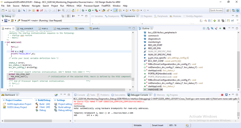

sushma
Hello Stanislav,
I have done the following changes and still not able to get the printf results on Console. Kindly tell me where I'm going wrong.
Thank you,
