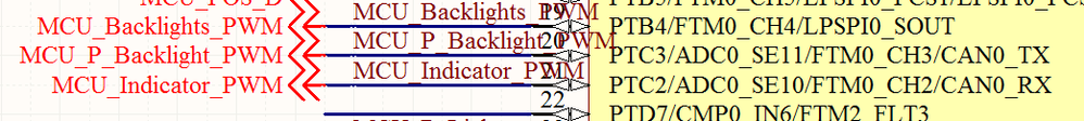

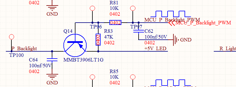

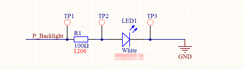

      In my design,MCU powers off earlier than power.Before MCU shutdown i will Pull PTC3 high,but if i shutdown the mcu,and then turn off the power the led will Flash once times。that mean it was low。
      How to check the status of IO (pull-up, pull-down, floating) under power-off?Configure the output attributes of the IO port so that the hardware connection cannot be changed(We are as PWM output).
      The pins are as follows:pastedImage_1.png
      Circuit design as shown:

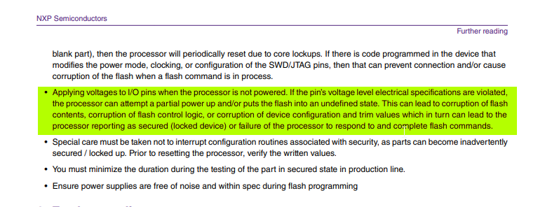

jiri_kral
you can find more details in this application note:
https://www.nxp.com/docs/en/application-note/AN12130.pdf
Jiri
3,783 Views
kemingkai
if I understand it correctly,applying voltages to I/O pins when the processor is not powered is not allowed.Regardless of whether the state is input or output.
3,783 Views
jiri_kral
Yes, you are right.
