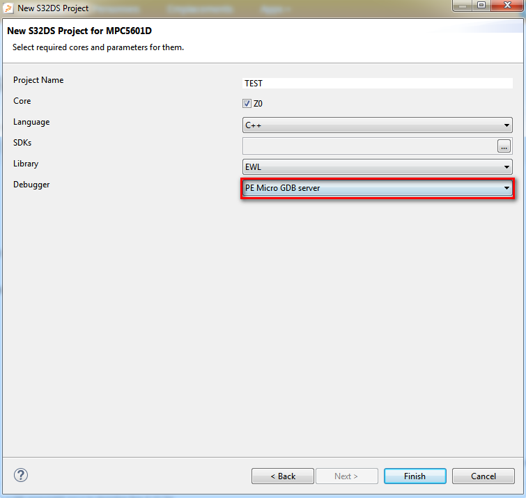

Hello ,
on version 1.1, i did not find PLS support on the project Wizard on MPC5601D
Did you support this debugger ?
                      Erwan

stanish
Hello Erwan,
The PLS debugger Eclipse Plugin is not installed by default in s32DS.
It's necessary to download it from pls-mc.com and install first. Once it's installed it should appear on the Debugger list  in project wizard.
I'm preparing step-by-step instructions. I'll post it on community as soon as it's ready.

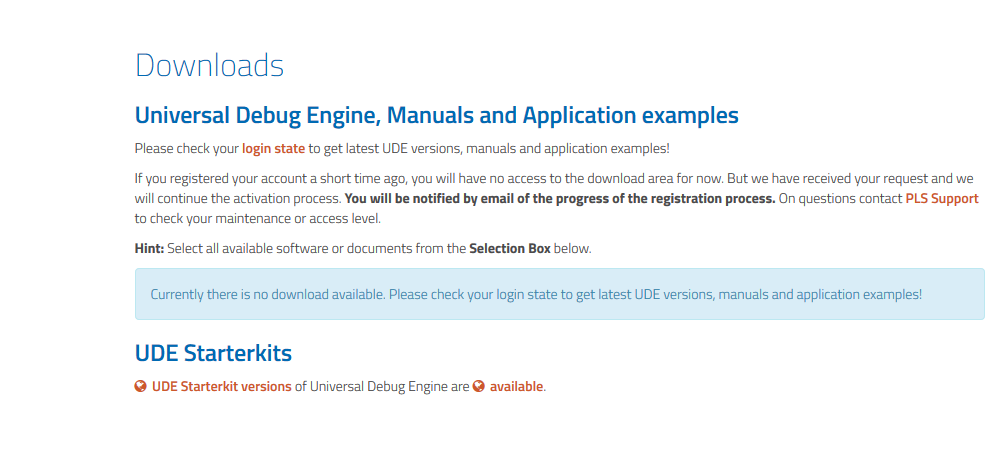

xuantruongdao
Hello Stan,
I see if want  to have plugin PLS for Eclipse, have to install PLS software. Could you tell me how i can  download Plugin only, I try to find in pls-mc.com but cannot.
Thank you so much.

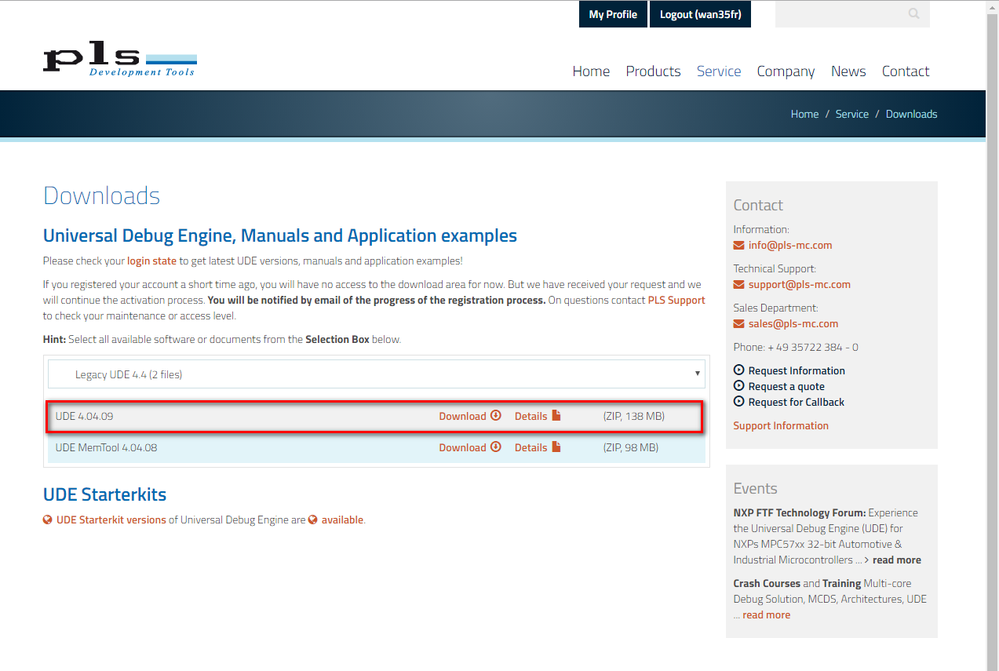

wan35fr
Hello Xuan ,
1) you can download  PLS UDE Engine from http://www.pls-mc.com
2) The PLS eclipse plugins should be installed in Program Files/UDE directory
3) Use Install New Software (Eclipse) to install a local update site in S32 Design Studio
                      Erwan

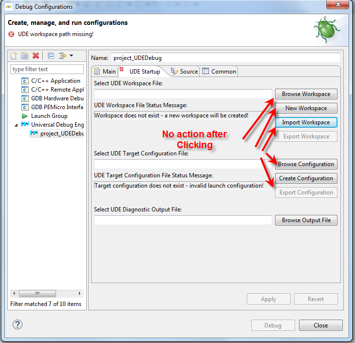

xuantruongdao
Hello Erwan,
Thank you so much, I did but cannot, may be my account is not be allowed.
I ask support team long time ago:
I don't have any hardware PLS as well as purchased UDE version. I need plugin only.
you  said you can debug and flash but I see a error in debug configuration - I think due to plugin or UDE not be installed in my machine.
Truong

wan35fr
Hello Stan ,
it is working well with Luna Eclipse Plugins from PLS ;-)
i can flash and debug with PLS from S32 Design Studio.
          Best Regards
